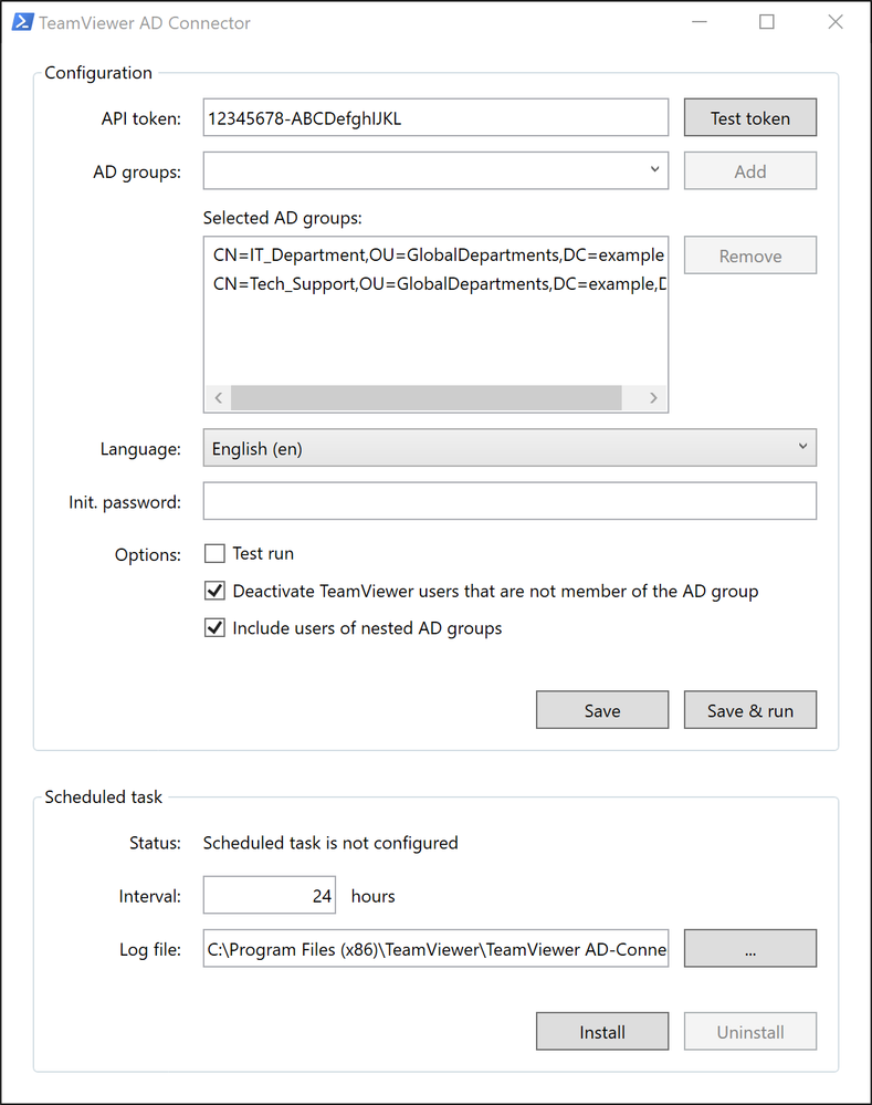

The TeamViewer AD Connector has two main areas such as Configuration and Scheduled task
The configuration UI provides the following features:
- Show and adapt the sync configuration.
- Validate the entered TeamViewer API token.
- Manually trigger a run of the synchronization script.
- Install/Uninstall a scheduled task to run the synchronization script automatically.

These are the available configuration parameters of the TeamViewer AD Connector
| Setting |
Description |
| Api token |

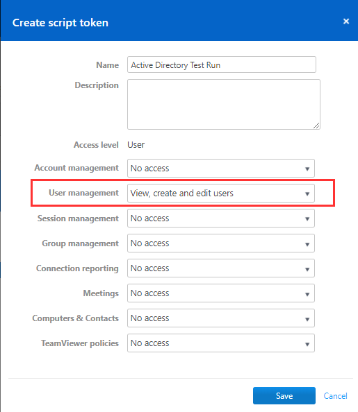

The TeamViewer API access token that is used for accessing the TeamViewer company user directory. You can create the script token in the Management Console --> Edit profile --> Apps --> Create script token. You only need the permission View, create and edit users for User Management:  |
| AD groups |
The LDAP identifier (without the leading `LDAP://` protocol scheme) of the AD groups used for the synchronization.
You do not need to run the AD Connector on a Domain Controller. All computers that are part of the domain can access the list of AD groups.
| Language |
The two-letter language identifier used as default language for newly created TeamViewer users. For example it is used to localize the "Welcome" email.
| Init. Password |
The initial password used for newly created TeamViewer users.
| Test run |
If set to `true` the synchronization will not modify any TeamViewer user resources but instead only log the actions that would have been executed.
| Deactivate TeamViewer Users that are not members of the AD group |
If set to `true` TeamViewer users that are not member of the selected AD group will be disabled
| Include users of nested AD groups |
If set to `true` users of nested AD groups will be included
