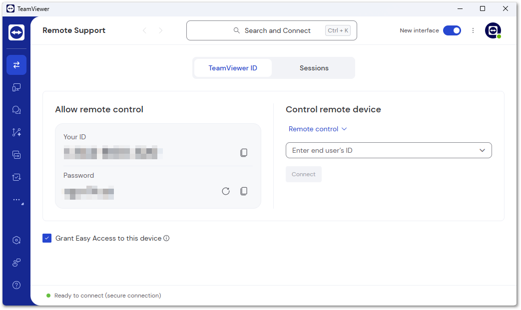

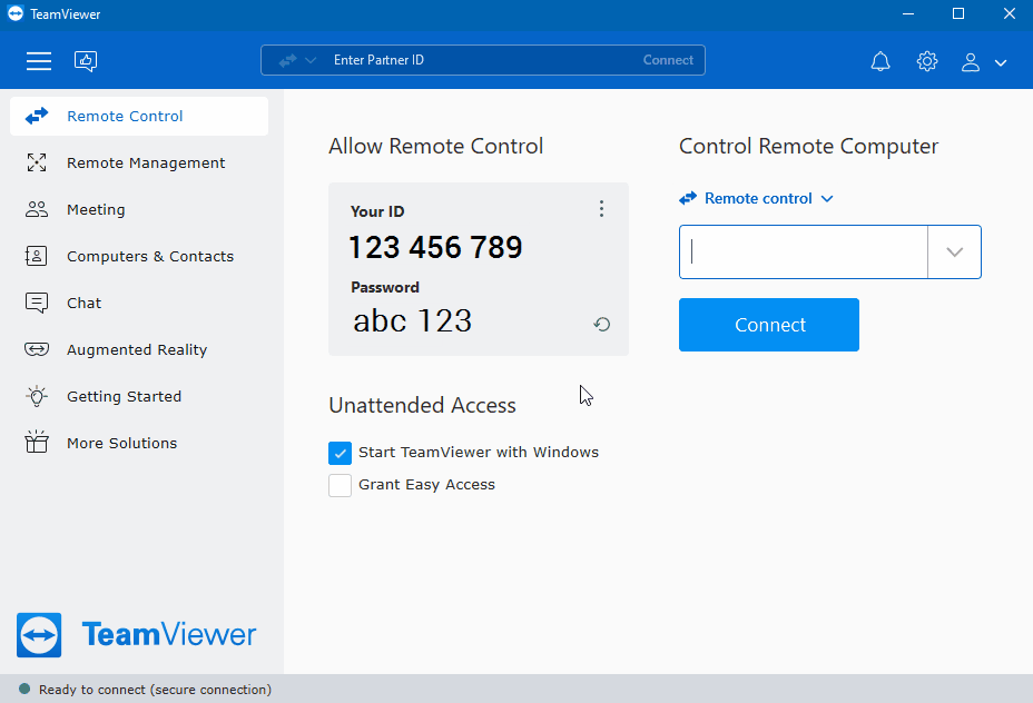

Update to this comment.
It worked, I had to switch to the new UI version of TeamViewer full client and SSO works perfectly. Then when I switch it back to the old UI it still works.
Can't understand why it did not work the first time and its going to be a pain to instruct users to do this.
