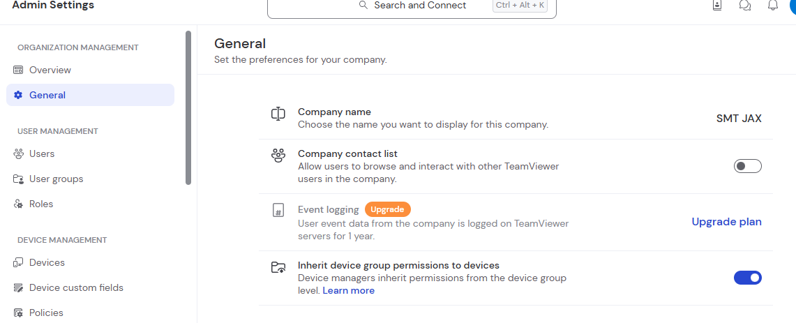

inherited permissions still do not work. We have a group with 30 devices in it. I add a manager to that group and give him "group admin" rights. That person does not have the ability to rename the devices in the group. When can we expect this to be resolved?
We DO have it enabled
they still do not work
to be clear, we DO have this setting enabled but it still does not work
@JeanK inherited permissions still do not work. We have a group with 30 devices in it. I add a manager to that group and give him "group admin" rights. That person does not have the ability to rename the devices in the group. When can we expect this to be resolved?

@bcatoe I just got the info that if you enabled the setting in the web app, you need to restart the client, so the setting gets applied. Does this explain why it wasn't working?
@bcatoe Thanks a lot for reporting this. I'm happy that you could solve the issue in the end. Regarding the inconsistency client/web app, I'll pass this over to the respective team so they can look at it.

@JeanK , well, that doesn't seem to work. We did those steps, the user still not inheriting device permission. And now when we click 'add managers' the message says "no assignable users'. So now we can't even add users to groups at all from inside the app but we just figured out we can from the website. This is very inconsistent.
@JeanK Wow, thank you!! 2 of us were banging our heads trying to figure this out.
