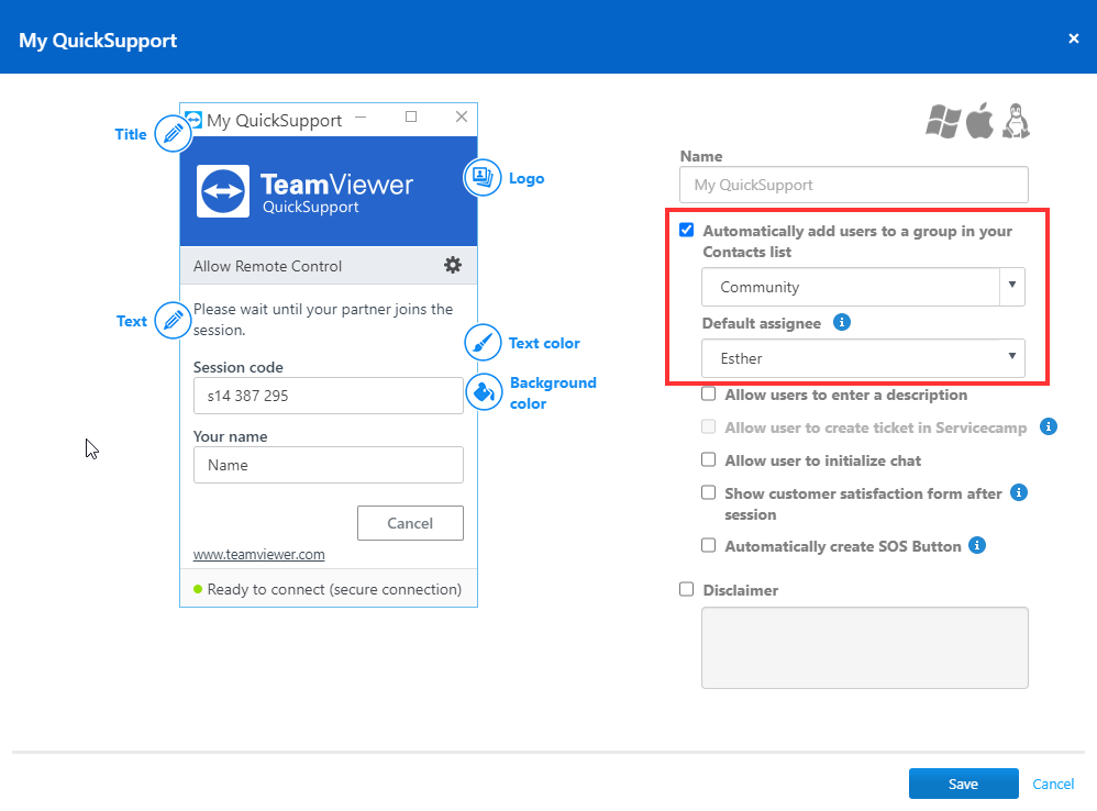

I can update to to Teamviewer 15 at my end but I need assistance to generate a registered Teamviewer 15 version quick support exe to be given to customers at our end so that I can connect without geting disconnected.
I tried to create a new one using management console but it shows only session id and not the ID and password for the customers to share the same with us to connect.

    If you want to continue using the TeamViewer ID and a password in the QuickSupport module you can do this of course. Just know, that this method is a bit outdated. The advantages of using the service queue are numerous - but depending on your use case, you can still opt in for ID and password. (I am linking to some additional information: Service queue)
    The default method is that Automatically add users to a group in your contacts list is enabled. As soon as you disable it, the module will prompt you with the old method.
