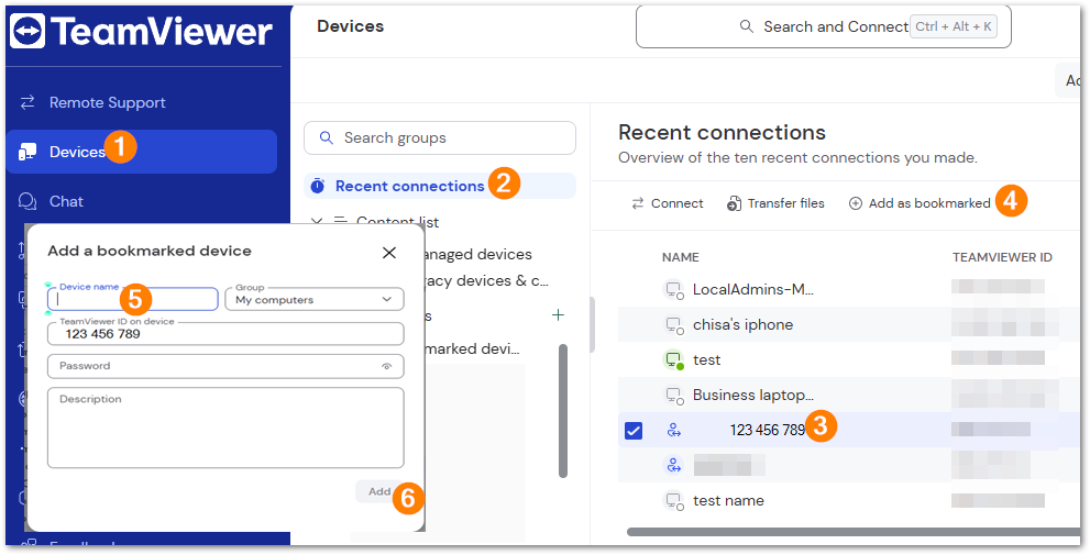

I use team viewer to connect to people who needs it support. I do have a participant list. Se pic. Some of the are named but not all.
How and where can I give the participant id a name?
Hi @kstrid,
Welcome to the Community 😊
Once you’ve added the devices to your bookmarks, you can begin assigning names to them.
To do so, please go to Device>Recent connections>click the target device ID>Add as bookmarked>write the alias of the device> add. Please refer to the image below to follow the steps.
I hope this helps!😀
Best,
Chisa
