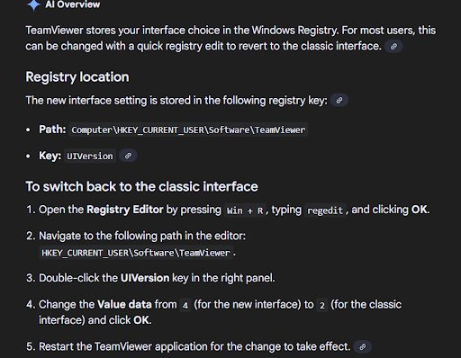

Is it possible that Teamviewer was automatically updated to the new interface? If Yes, how can I prevent this in future?
In any case, somehow the computer with this Webview2 issue was updated to the new version (which is working fine on my desktop) was updated to the new version. Even with Webview2 turned off Teamviewer was still using WebView2 and hogging CPU resource.
I switched back to the classic interface and the problem stopped. I am concerned that if any auto update occies I will be back to to the same problem.

Even after unchecking Edge WebView2, after a restart it is still being used by TeamViewer - though with much less CPU resource.
What can I do to prevent the use of Edge Webview2?
Not a question - trying to help other who have spent hours trying to figure out why Edge Webview2 is hogging CPU and trying to disable it.
I remotely logged into my relatives low power windows 10 laptop to find why it was very unresponsive.
It turns out that it was TeamVierers use of Edge WebView2 by default that was causing th issue.
A big thanks to @glenvee who gives the answer here:
The new Teamviewer UI uses Microsoft Edge WebView2, which comes as part of Edge, although it can be installed separately without Edge as far as I know. In Teamviewer Options> Advanced, all the way at the bottom is a heading "IoT Options" which has a checkbox for "Use Microsoft Edge WebView2 for Remote AppControl"
(I am using the classic interface)
Edge WebView2 unchecked at
Settings/Advanced Settings/(open advanced Settings)
Unchecked Use Webview2 at bottom (IoT options)
Laptop responsiveness is now perfect for the uses the computer is used for.
