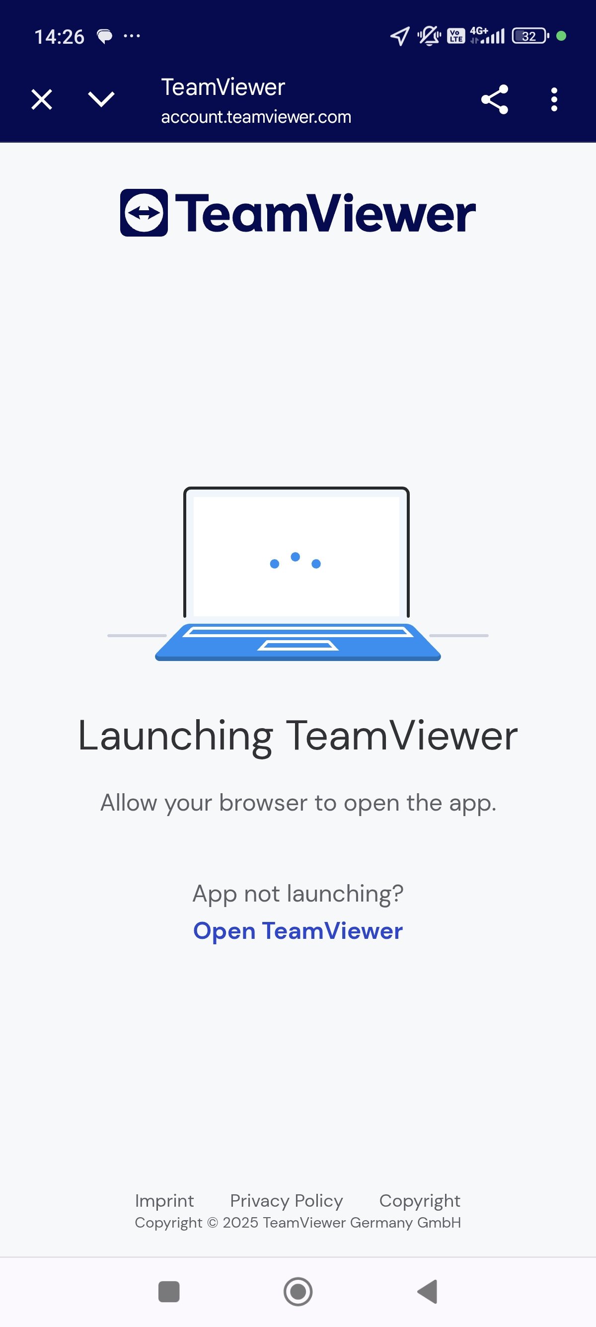

I am using teamviewer since last 2 year and never faced this issue, i recentlswitched to a new device (samsung s24 fe smart phone an android device ) and downloaddownloaded teamviewer in it but when I try to login I get stuck at a browser window showing "launching teamviewer allow your browser to open the app" and there is an option "app not launching?" And a highlighted option "open teamviewer" but that's not also working so any anyone can please help me out of this mess ?
Here is a screenshot attached with it if anyone want to see.
please help me.

after I login to google it says launching teamviewer and just stays there. The open app button doesn’t do anything. I have tried with cellular and Wi-Fi. I have restarted my phone, cleared cookies, reinstalled the app, turned on all permissions including storage. I have tried copying the url to multiple browsers and incognito mode and still gets stuck on the same page. Is there anything else i can try besides using teamviewer through a browser instead of the app?

Any update regarding this issue? The link now says "app not launching? open teamviewer" instead of "use teamviewer in your browser" but it is unclickable and the app is still unusable.

Since updating to version 15.69.835 of the TeamViewer mobile app, I have been unable to log in correctly.After entering my credentials in the browser popup, the app does not return from the browser and instead shows the message: "Allow the browser to open the application."

As per several others in this thread, "Everytime i try to log-in on Android, it redirects me to an embedded browser. Where after I log-in I get the launching Teamviewer screen, which seems to think I'm on a computer and doesn't reopen/return to the Android app, which means I can't log-in."

I'm encountering the same problem, creating a situation where Teamviewer can't be used. Everytime i try to log-in on Android, it redirects me to an embedded browser. Where after I log-in I get the launching Teamviewer screen, which seems to think I'm on a computer and doesn't reopen/return to the Android app, which means I can't log-in.

When trying to sign in through the android app, the redirect keeps assuming you are on a browser, and is asking to launch the desktop app, meaning, you're locked out from logging in Teamviewer through android at all. And for confirmation, that screenshot above IS THE TEAMVIEWER app, it's not the main browser. No one's trying to use teamviewer on the browser.
